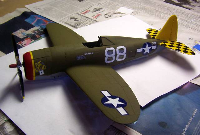

Decaling has always been my favorite part of building models. This is when your plain Jane , olive drab airplane starts to take on her identity and personality; the stuff that sets her apart from all her sisters. The scheme I chose was for Col. Robert Baseler’s airplane, “Big Stud”, of the 325th FG, the “Checkertails”. The tail checks were from Superscale sheet # 3214, and the rest of the markings were taken from Microscale sheet # 32-24.

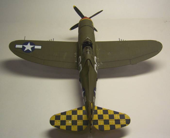

Not having done this in quite a while, I have to admit I was a little antsy. I did the lower stab checks first, since one of the airplanes on the sheet did not have checks there, and if I screwed up, there was still a chance of salvaging the markings. But the tail markings went on with no problems at all, snuggled down well with a little Solvaset, AND lined up perfectly with one another. Am I good, or what!?
Things sort of went downhill from there. Getting cocky can be a bad thing…..The national markings went on next, and all was well until I got to the left fuselage stars and bars, which tore as I was sliding them off the sheet. Panic? Me? Darn straight I did!! Lots of water and patience got all the pieces back together and in place, which was a fine thing, since I didn’t have any spares. Two of the “8’s” in the buzz numbers did the same thing, but I was a pro by now and I managed to salvage them as well. Practice DOES make perfect. Well, sort of… Everything else went on with no problems. Then I realized I hadn’t glosscoated the model before putting the decals on!! Doh! Live and learn. They look ok, though, and I’m happy with them. A few light shots of Dullcoat completed the decal work.
I did a little light weathering in the high wear areas, drybrushing some zinc chromate or silver in high wear areas. A dark gray wash filled in all the control surface gaps and the areas around the cowl, while the wheel wells got the gray mixed with a little dark brown.

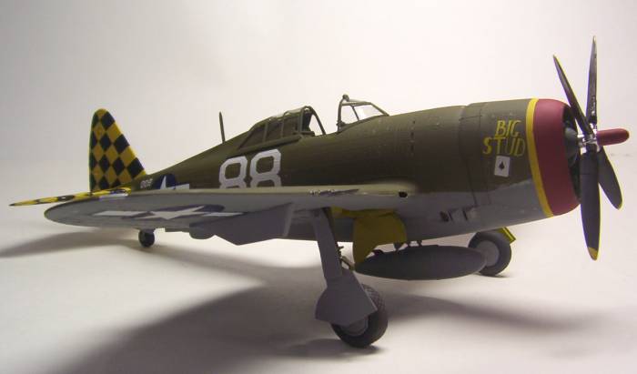

It was time to start putting things together. Landing gear was assembled and painted, as was the drop tank. Wing guns were made from 1/16” tubing and glued into place. A set of Monogram P-61 turret guns provided a good excuse for the missing pitot tube, and some unidentified kit from a galaxy far, far away donated the radio mast and gunsight. I tried three times to mask the canopy, the second time I actually got the tape all cut away, only to realize I had left the frames taped and the glass uncovered. Yes, I was paying attention. Really. I finally bit the bullet and freehand painted the frames, first with interior green, then with olive drab. That came out ok, too, but I think I’ll hire somebody to do that next time…
Home stretch!! Gear, canopy and drop tank went on, followed by the tailwheel and all the gear doors. I let her dry upside down overnight and then…….she was FINISHED!!!
I can’t describe how good it felt. She won’t win any contests, but she looks like a P-47, and has the “shelf presence” that that airplane should have. I could probably do a little more detailing, but she’s been waiting to see daylight for close to 25 years, so I’ll just leave her be. She earned it.

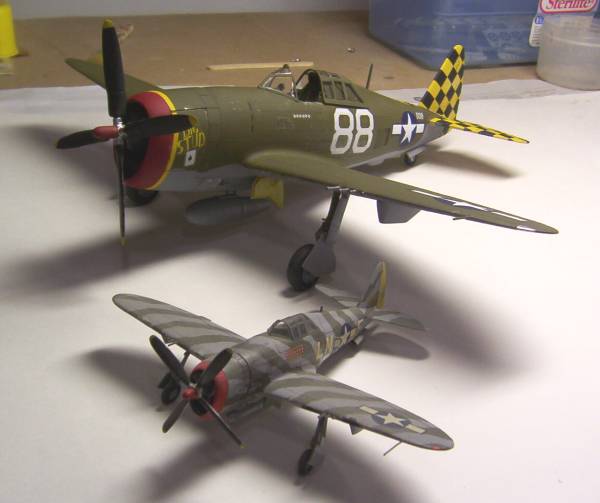

Just for grins, I took a shot of the new Jug with the last P-47 I built, a Jo-Han 1/72 Razorback with Esci decals that I did in 1975. What a difference a few years makes...
