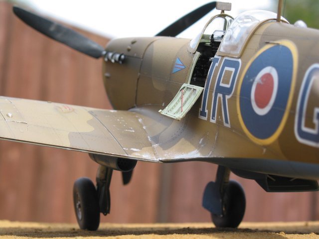

The kit itself represents a bit of a mix of Mk V variants in that, for example, it has and early type of front windscreen, short spinner coupled with a De Havilland propeller and the later Mk V 'fishtail' exhaust stacks. I find this sort of thing a little irritating when the rest of the kit is so well produced, I live with it though. For the version I was building however, I had a spare set of Rotol blades and long spinner so I was able to overcome the problem. The Seat is also inaccurate; it wasn't a wooden bench affair as depicted in the model. I have fitted it for now, but since building the kit, a resin replacement is now available so it will be being pulled out at some stage.

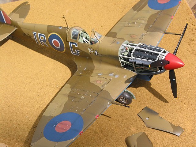

Like the Trumpeter Mustang before it, the engine is a disappointment with far too few rocker cover studs to name but one fault. (a bit of fiddling with the file sorted this one) However, it isn't as bad as the Packard Merlin so I spent a bit of time adding a little detail here and there to get the overall effect. There is so much scope for super detailing in this scale, I chose to limit this at a few extra cables and coolant pipes etc.

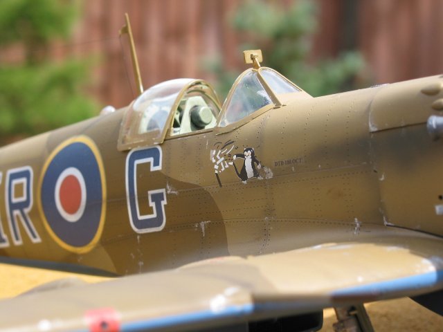

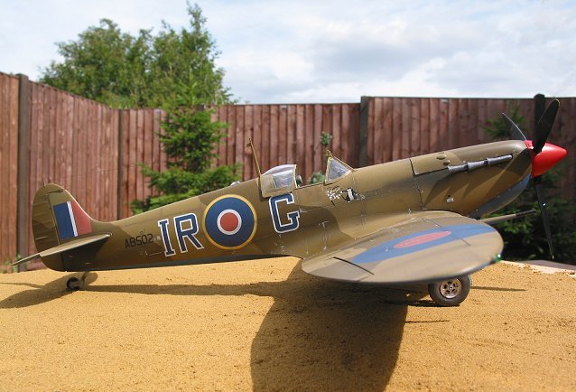

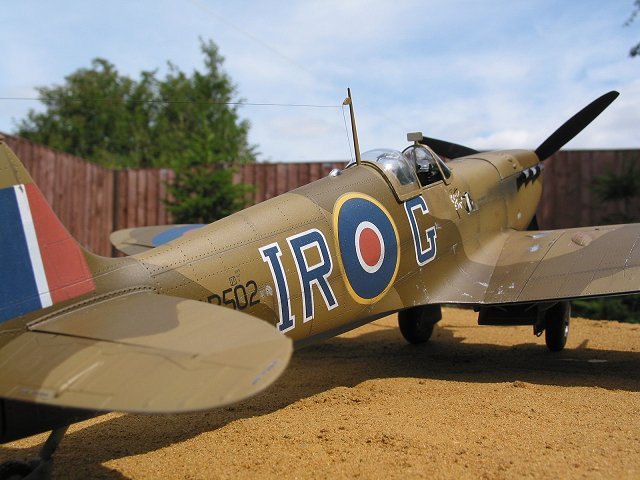

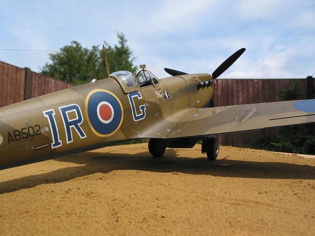

I was visiting Duxford early in 2003 and saw the BBMF's Mk V AB910 being repainted in Flt Lt Ian R Gleed's tropical colours when he was flying AB502 with 601 sqn. It looked stunning and Airfix had these exact colours in their latest offering of the Mk Vb. So the Aifix decal set was used on the Trumpeter kit again (as with my P-51D)! The Paint used is Humbrol enamel (my favourite choice) splashed on with my faithful Aztec Airbrush. I didn't go too mad with weathering although these aircraft would have suffered greatly with the effects of sun and sand in the North African desert conditions. In hindsight it would have looked a bit worse than this after a few months in the desert. Oh yes, I nicked the Abourkir tropical filter from my Airfix kit as well; It was the wrong shape but with a little filing here and there, it looks roughly right!
Even with its inaccuracies this kit builds into a wonderful looking aircraft it is certainly the best of its scale - it looks just about right; simple as that!
