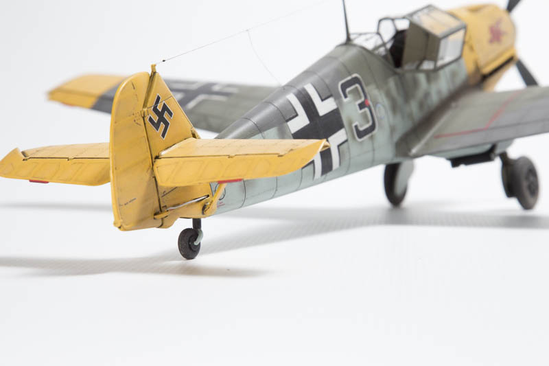

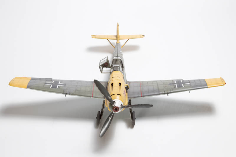

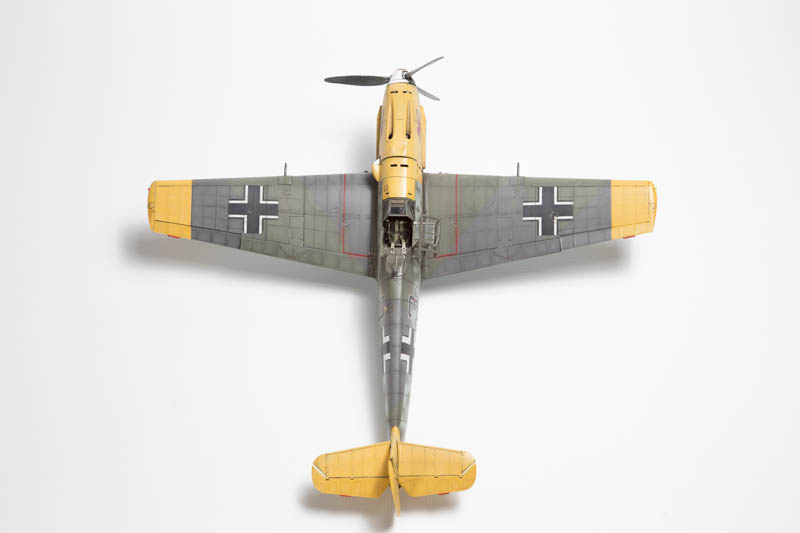

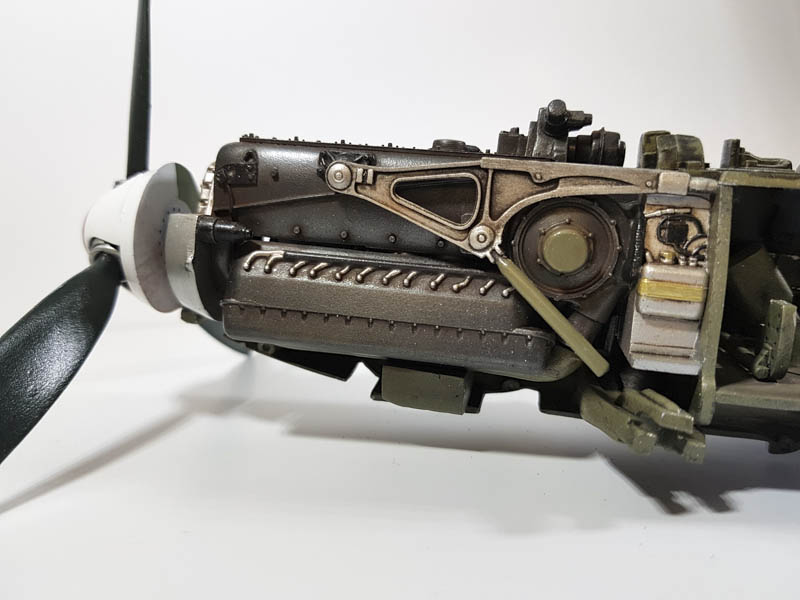

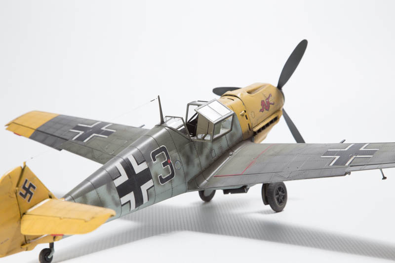

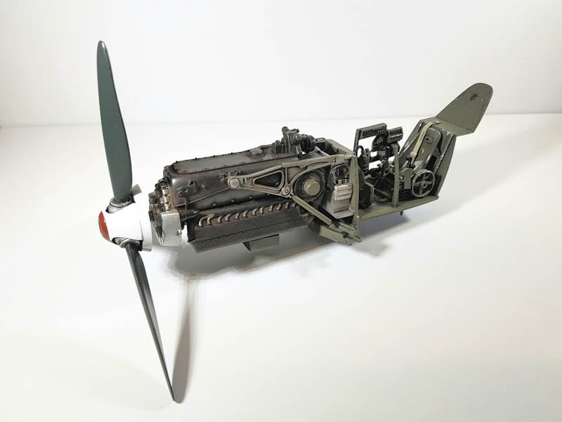

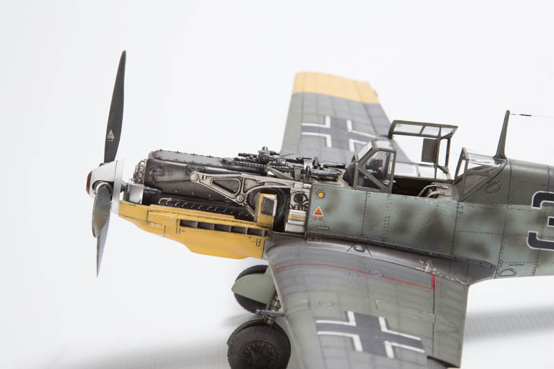

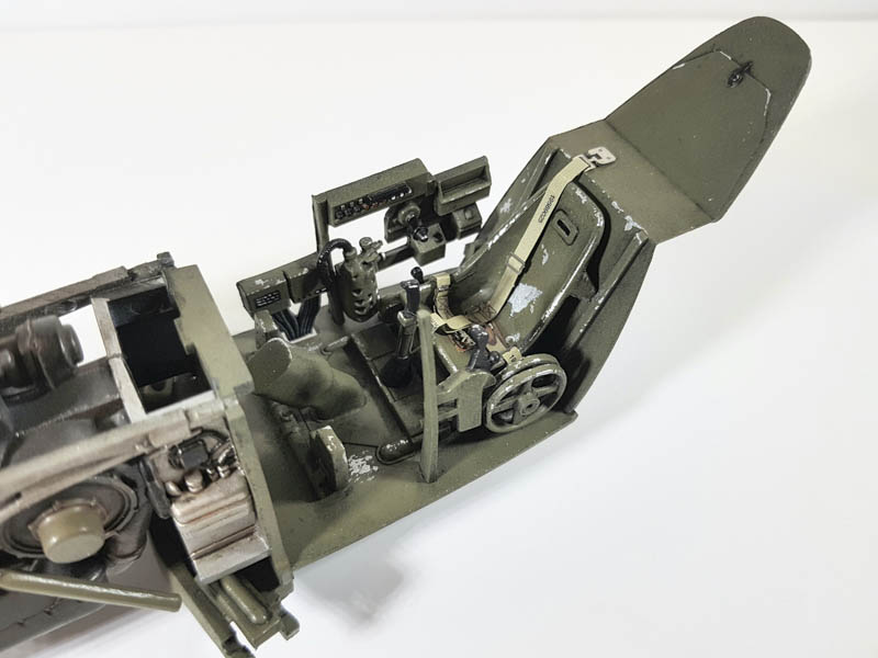

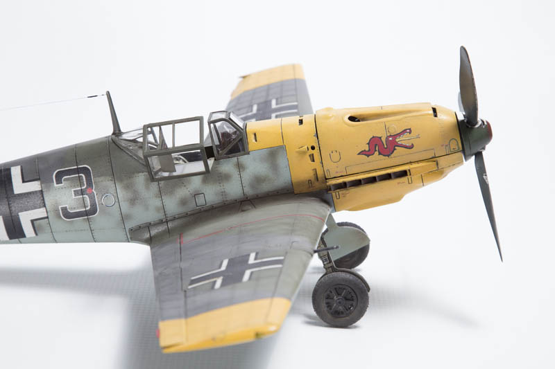

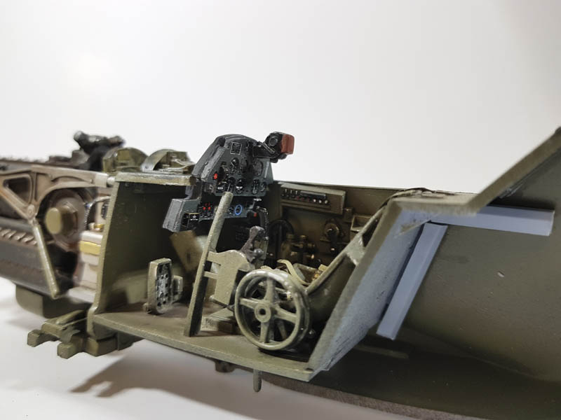

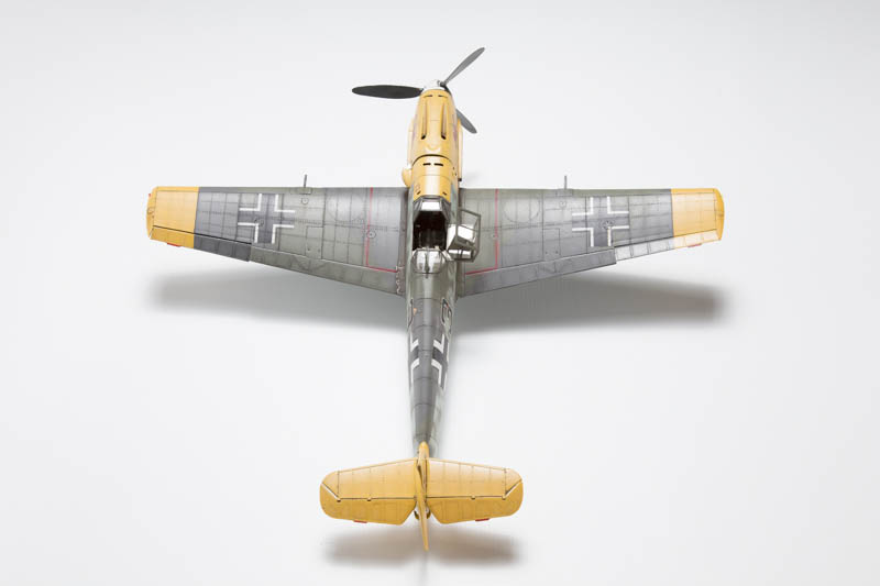

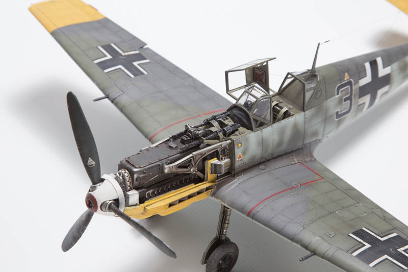

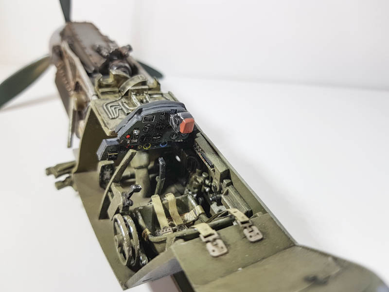

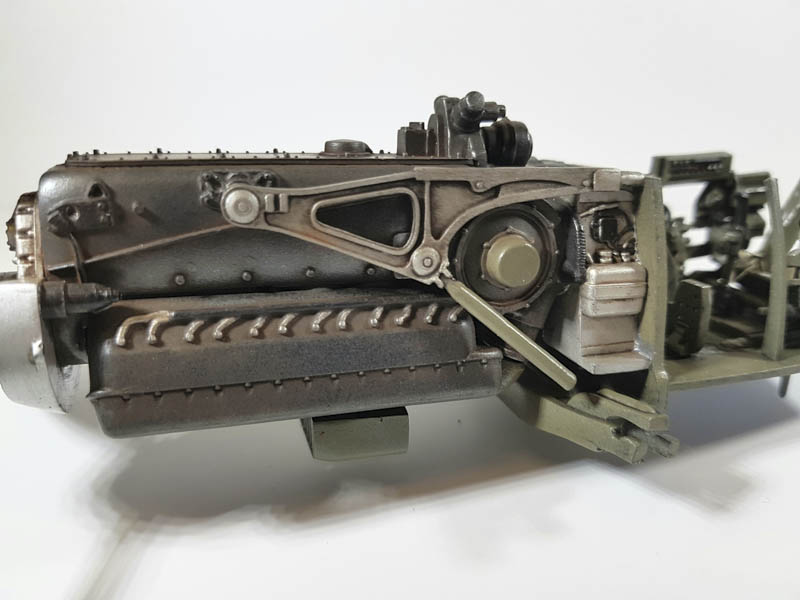

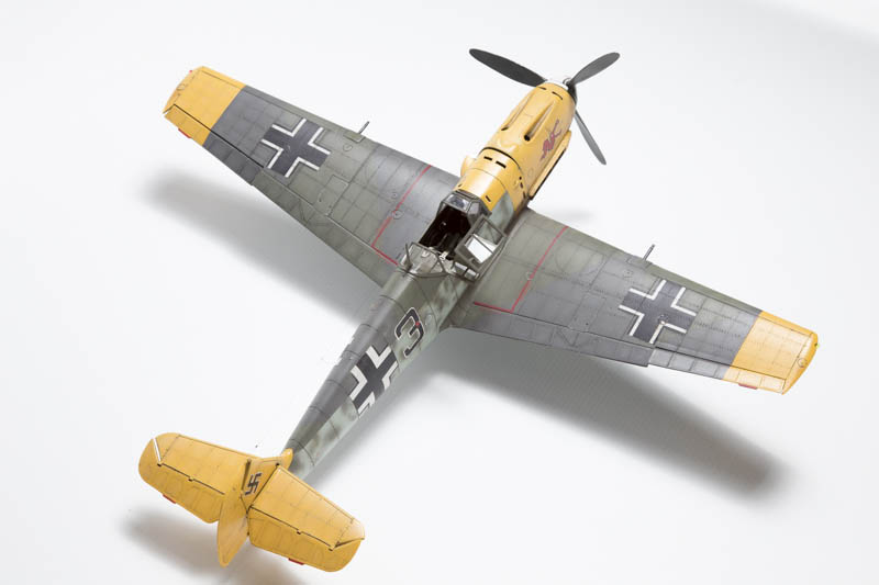

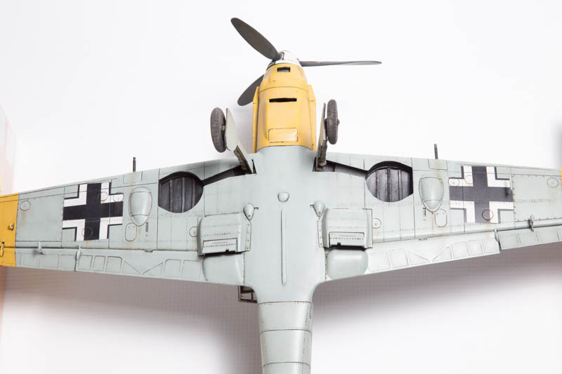

The build itself was mostly straightforward, although I wish I’d checked my references beforehand. There are three issues with my final model: the Eduard instructions for the seatbelts had me fixing them to the rear shelf instead of through the seat back; I put three cross-ribs in the wheel wells instead of two; and I’m not convinced by the RLM 74 and 75 colours as required in the Montex mask instructions (the aircraft represented is a Bf 109E-4 of 2/JG 3, France, 1940). There were no real fit issues apart from the cowling (styrene strip and adjusting the height of the guns did the trick) and the IP needed to be lowered/reshaped to fit under the canopy.

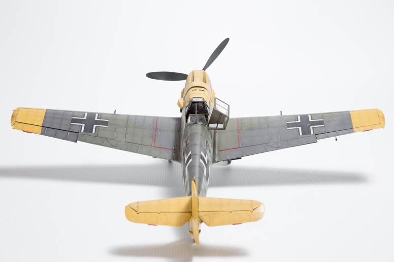

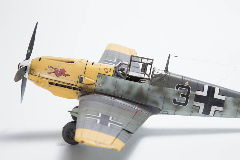

This was my first attempt at using paint masks for insignia etc and I have to say it was easier than I expected. The semi-transparent nature of the masks makes for easy alignment (albeit with a pair of close-up specs for the multi-part dragon mask) and various YouTube videos helped me with the order of mask and paint. For anyone considering using the masks, my key recommendation would be to work hard on fixing down the edges – these vinyl masks don’t have the adhesion of the kabuki versions.
Paints used were a mix of Tamiya, Vallejo and AK Interactive. Weathering was courtesy of Flory and Mig products.

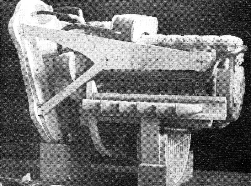

The 1/12th scale Stuka engine pattern on its bearer which is pantographed down to half this size onto the metal die by the toolmaker.

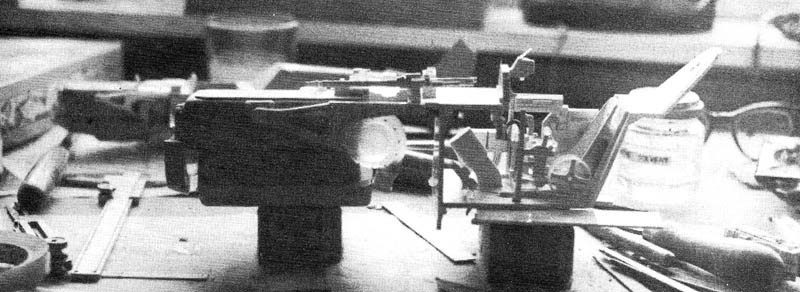

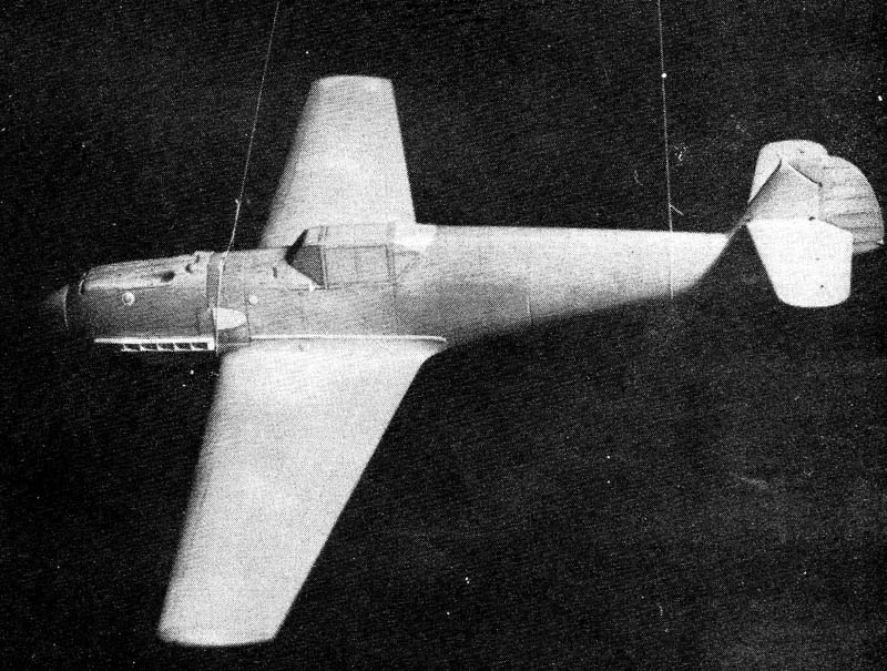

The prototype model is started, commencing with the fuselage carved from lime wood. Two halves are temporarily glued together and shaped against form templates. The windscreen and cockpit canopy are shaped and fitted, plus the addition of wing roots and fairings.
The prototype fuselage for a 1/24th scale model is made to the same size allowing .006 in. to the inch for shrinkage of hot plastic as it cools from the mould. Prototypes are only made to the size of the final model when it is a large scale like 1/24th. Similar scales, namely 1/48th, are made 1½ times final size and 1/72nd scale are made twice size. When the fuselage is completed, the wings and tail unit are made in the same way. Top and bottom of the wings are glued together as was the fuselage. The join acts as a datum line between the two halves and aids accuracy.

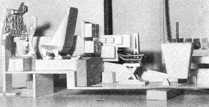

Part of the Stuka cockpit interior cast up, again twice size, in resin.
When they are finished in this form, the half is mounted onto a flat base. These are then cast in a hard industrial resin to give a female mould. A thin layer of wax is laid into the mould to the wall thickness of the final model. More resin is now poured into the mould over the waxed area. When set the moulds are separated and the wax is removed from the mould. The gap between the two moulds caused by the layer of wax is the area that we are interested in. The female mould is known as the cavity and the male mould is the core. Now the two moulds can be coupled together and more resin is poured into the space between the moulds. The resulting case is known as a quick or temporary cast. This is a very valuable step in the procedure as it enables one to see the final cast at an early stage.

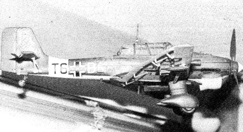

The finished Airfix 1/24 Stuka hanging from the roof in Pat’s workshop
This case or shell is essential in the production of the cockpit interior, the bulkheads engine, and also the wings when there is a necessity to fit a retracting undercarriage or mount wing guns. The cockpit interior is planned by making a series of form templates to fit the inside of the shell in their correct positions. The bulkheads, instrument panel and floor are made in this way. When they are finished in this form, they are taken out of the shell and disassembled. The patterns for the cockpit interior can be made at a large scale to facilitate better detailing. The method I use is to place the templates that have been disassembled under the lends of an enlarging projector and make tracings of the parts to twice scale. This being done, the items can be made and are ensured of fitting the model on later reduction. When all the patterns are finished in detail, they are then ready for mounting as was the fuselage earlier on. But this time the mounting is more complicated. The split line between the two moulds is not always a straight line. This is not easy to explain clearly in words. The next time you open a kit box, see if you can spot where the join is and try to imagine the difficulty, remembering also that every item has to maintain a draught angle or taper to facilitate its withdrawal from the mould.
After all the parts have been cast in their resins they are then ready to be cut into their final metal dies. This is where the toolmaker comes on the scene. He cuts into the metal die or mould, using a pantograph. The pantograph is a device that will reproduce an exact shape it is made to follow, in either the same size or a different scale. In our case the pantograph probe is guided over the surface of the female resin mould (made from my original model) and as this is done the pantograph cutter will reproduce the identical shape into a metal block; this is known as the die.

Another 1/24th plastic kit on which Pat Tranfield worked was the Airfix Messerschmitt 109E.
The resin pattern for the 109E
