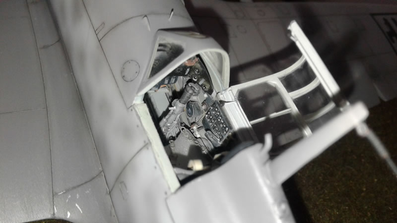

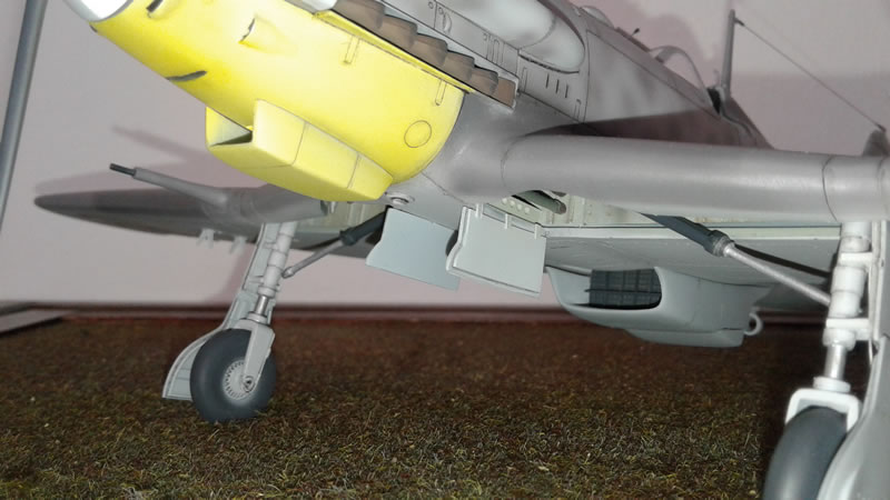

The Model

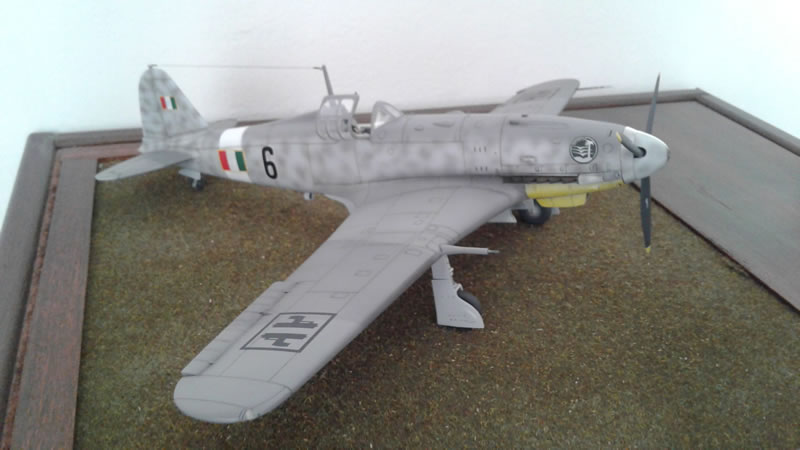

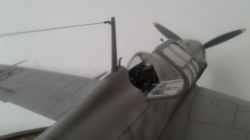

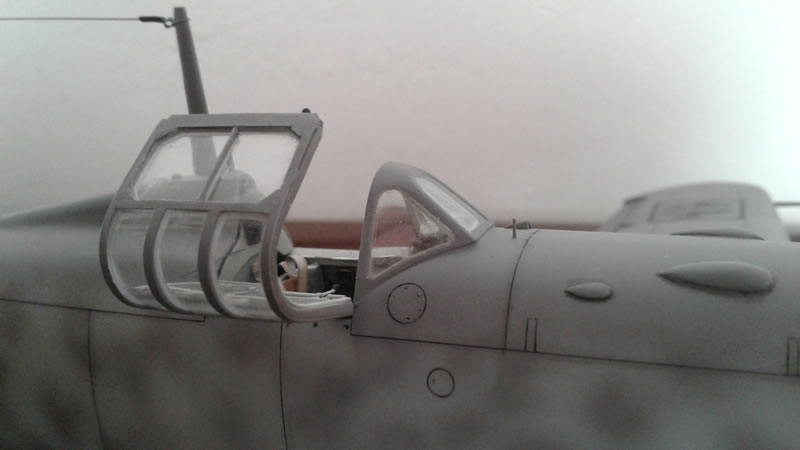

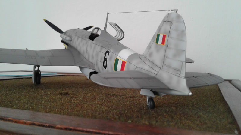

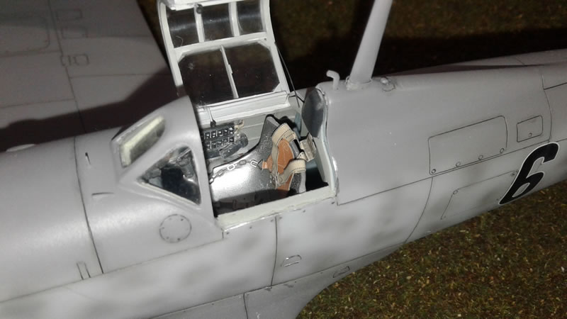

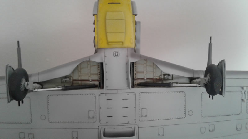

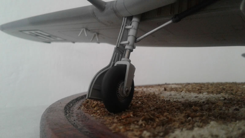

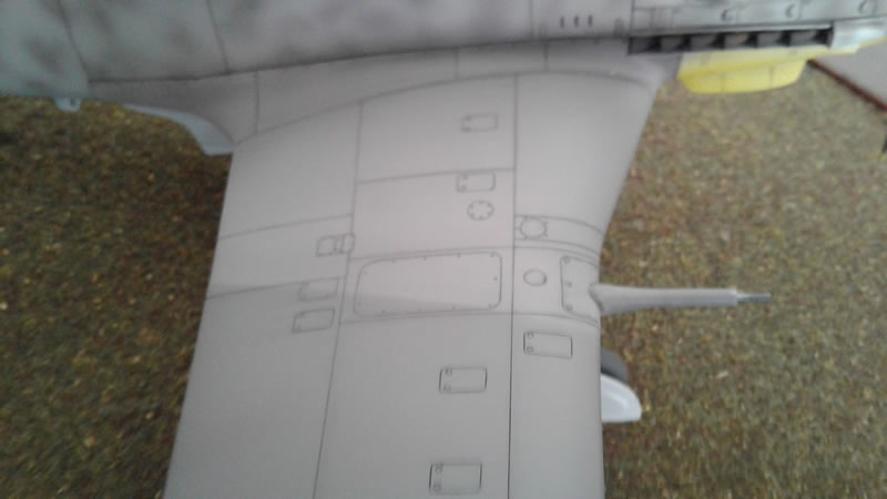

Built in plastic parts, resin reproducing cockpit and main landing gear bay it's joined by photo-etched parts. It's Short Run Kit and is the only one in 1/32 scale, I enjoyed myself during the construction of this kit, in fact building has not create any problems. I decided to separate the surfaces of the ailerons, of the elevators and rudder only to give it a maximum realism, in terms of production design and easy to assembly. The resin detail parts are very nice and I've not spent a lot of time assembling them.

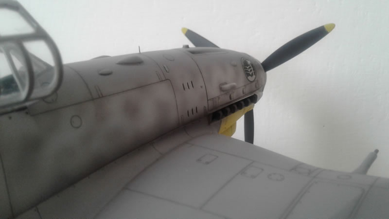

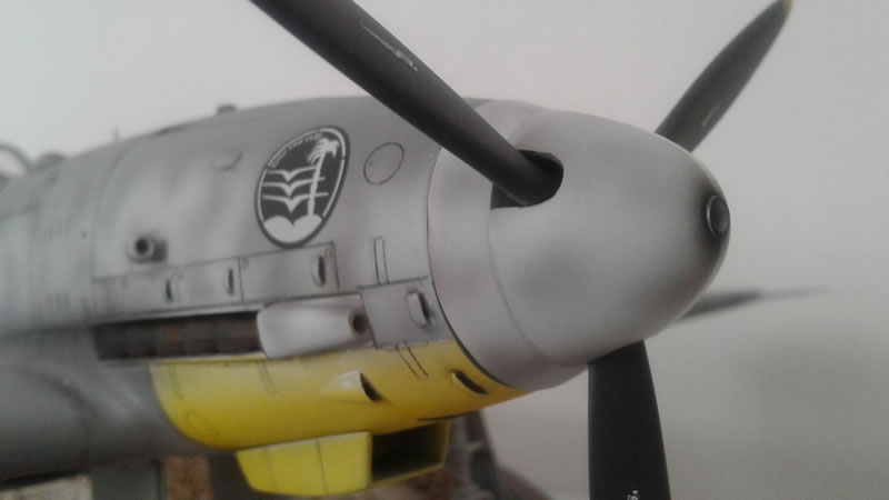

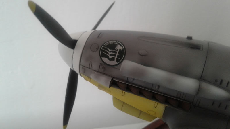

Painting and Markings

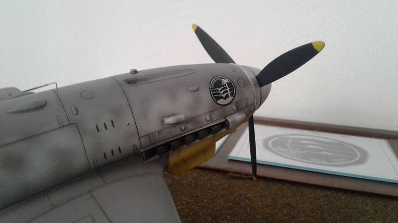

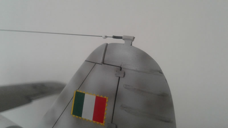

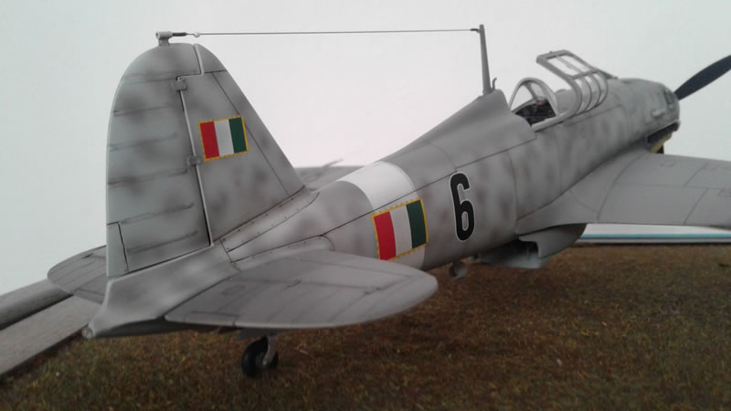

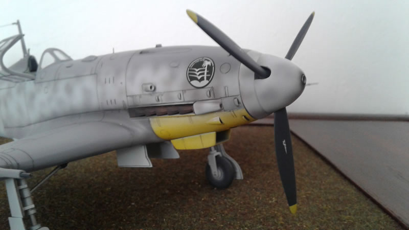

I decided to do my Centauro as G -55 1^ Squadriglia, Secondo Gruppo Caccia based in Cascina Vaga (Pavia) in gray camouflage R.L.M. 74/75/76. The insignia Squadron "Gigi Tre Osei" painted in each side of the cowling engine, wing fasces on the upper wing have a clear background, while the lower ones are usually white with R.L.M. 76 paint scheme. For painting the model I've used Gunze Sangyo acrylic colours sprayed with airbrush Paashe; the Cartograf Decals are very nice, I applied them without any problem under a couple coats of Mr. Mark Softer Gunze. I washed the model with oil black for giving it a used appearance. I applied exhaust stains with black Tamiya Smoke, after I gave a final coat of Microscale Microflat for a flatter finish real. Real Fiat G-55 Centauro 6 black (1^ Sq. 2^ Gr.C.) was used in dogfight in North Italy on 1944 by Sottotenente Pilota Amedeo Fagiano.
