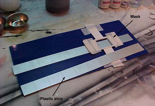

Next I apply different clear coats on the strip, using the scribed lines as borders. To avoid masking (and you know some metalizers don't like masks), I made a custom mask to simplify the task.
Applying the clear finishes on the metalized strips.
My custom made mask.
It is not necessary to be accurate here. The idea is to use the scribed lines as a reference, and avoid significant overspray over the adjacent areas. It's OK if you misplace the mask by one or two mm.

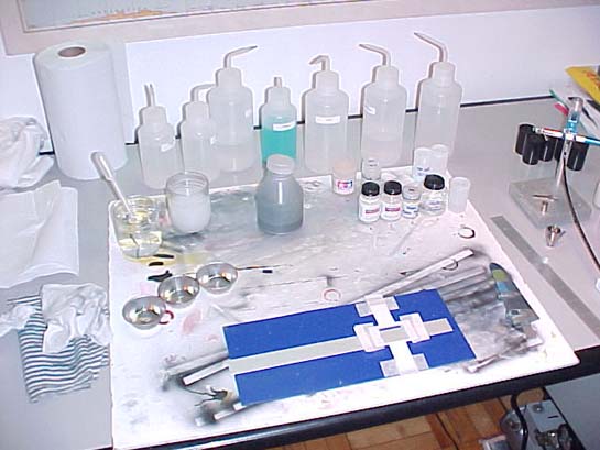

Here's a picture of my workbench during one of these sections. The large number of thinners on the background is due to the different nature of the clear coats I used.
Applying the clear coats.
