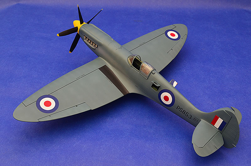

Here's the latest project to cross the finish line - the 1970s original issue 1/32nd scale Spitfire Mk I which has been used as the base kit to produce a Spitfire PRXIX using Grey Matter's conversion set.
I chose the original Revell kit rather than the latest release due to the far superior surface detailing (and the fact that it was picked up cheaply at an airshow!) and although it has an issue with the lack of the gull wing effect on the underside I found that far easier to live with than the ridiculously over-scale trenches and rivets seen on the latest Revell offering.

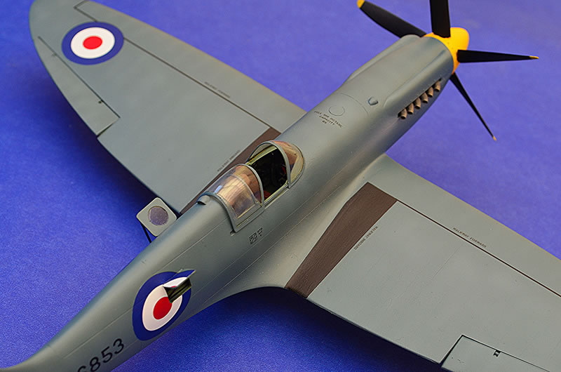

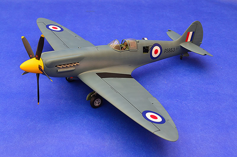

The conversion provides a completely new nose section for the big Griffon engine, a new tail fin and rudder, replacement elevators, new propeller, two new radiators and a vacformed canopy for the pressurised cockpit.
Work began by modifying the Mk I wing - the radiator and oil cooler were removed, along with carburetor intake. The kit didn't have any wheel well detail so this was scratch-built, and the cartridge ejector ports were also blanked off.
The fuselage had the Merlin engine cut off at the firewall, I modified and installed an aftermarket cockpit set to replace the basic detail in the kit, and I also scratch-built the camera bays in the rear fuselage.
The original nose was then replaced with the resin Griffon one, the Mk I tail was sliced off and the resin replacement installed, and the gun bay covers were all filled as of course the PRXIX was unarmed.
The Grey Matter conversion kit didn't supply any decals, so I used ModelDecal serials, Xtradecal roundels and the new HGW Spitfire stencil set. Xtracolour enamels were used throughout the build.
1/32nd Scale Spitfire PRXIX PS853 of the Meteorological Flight, RAF Woodvale, 1953
