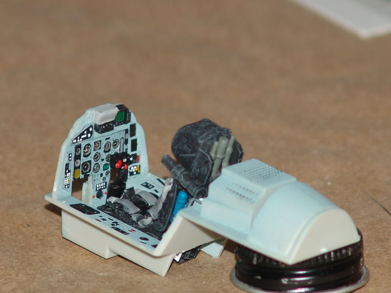

The kit cockpit really needs sprucing up. I replaced the kit seat with a Black Box resin seat robbed from my Flanker set and used the Eduard PE for the IP. I added some spare plastic bits for more detail as well. Since I planned on closing the canopy I didn't go hog wild with the detail.
